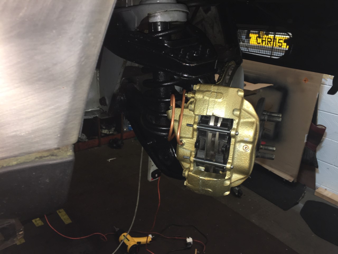

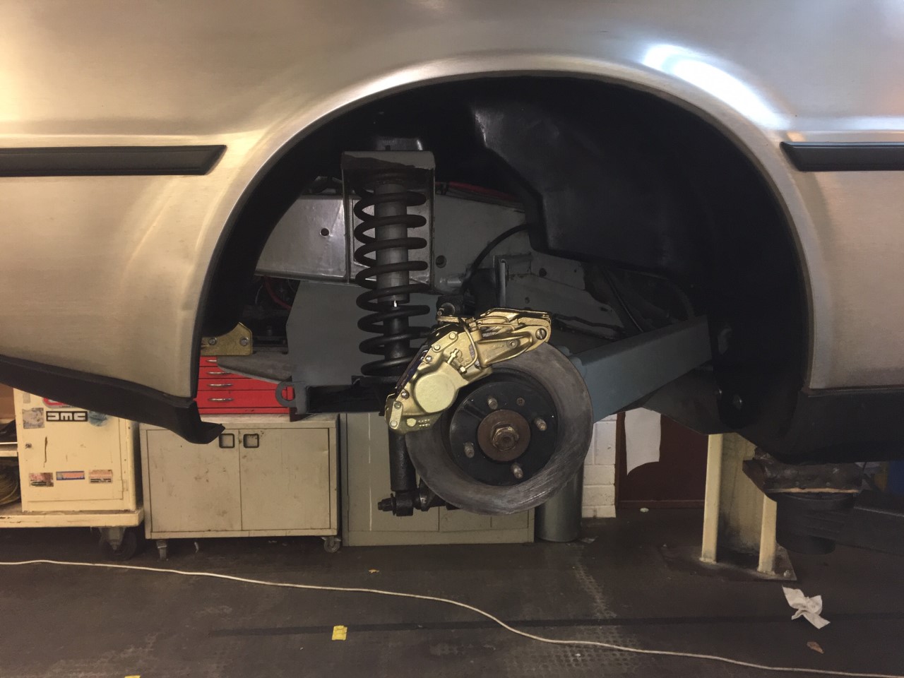

                A little update...most of the latest work has been on the brakes. Restored callipers and an upgrade on the front, with 4 pot Princess callipers and ventilated discs. New wheel bearings and flexible brake pipes.
 Getting stuff to bits has been a challenge!  Most things were seized solid and requiring lots of heat, freeing oil and time and patience!.......onwards and upwards .....TooT TooT.

Nice upgrade at the front Chris.
I'm just about to refurbish my calipers, did you do them yourself or was it a company?

Quote:A little update...most of the latest work has been on the brakes. Restored callipers and an upgrade on the front, with 4 pot Princess callipers and ventilated discs. New wheel bearings and flexible brake pipes.
Ohh they look nice, did you have them or did you manage to find the calipers? I take it they are Ed's ventilated discs?

All looking superb Chris!
I agree with everyone, I’m liking those callipers!!!
Coming along nicely.

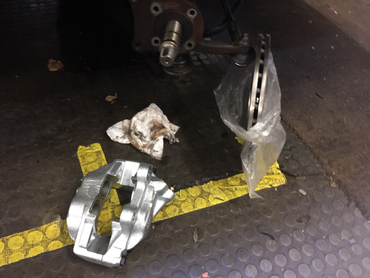

This is an interesting article about the Princess callipers.   http://www.cjw-consulting.co.uk/4pots/4pots.htm
There seems to have been a few versions over the years and 10 years ago they were like 'hens teeth', I think they must have been re-manufactured since then.
The eBay link I sent were the one's I bought...mainly because you got the whole deal...pads, pins etc. They are even cheaper if you buy 2 sets! (Two cars worth).

Quote:I suppose Arran gets them from Ed, but I've never asked
Yep the discs are Ed's but the calipers Arran sells are the normal ones with a spacer kit. Yours seem a much better option. Better get some money spent!
I'm pondering this upgrade too I'm chuffed it's bolt on, Aren't the vented discs from a mk1 Golf?

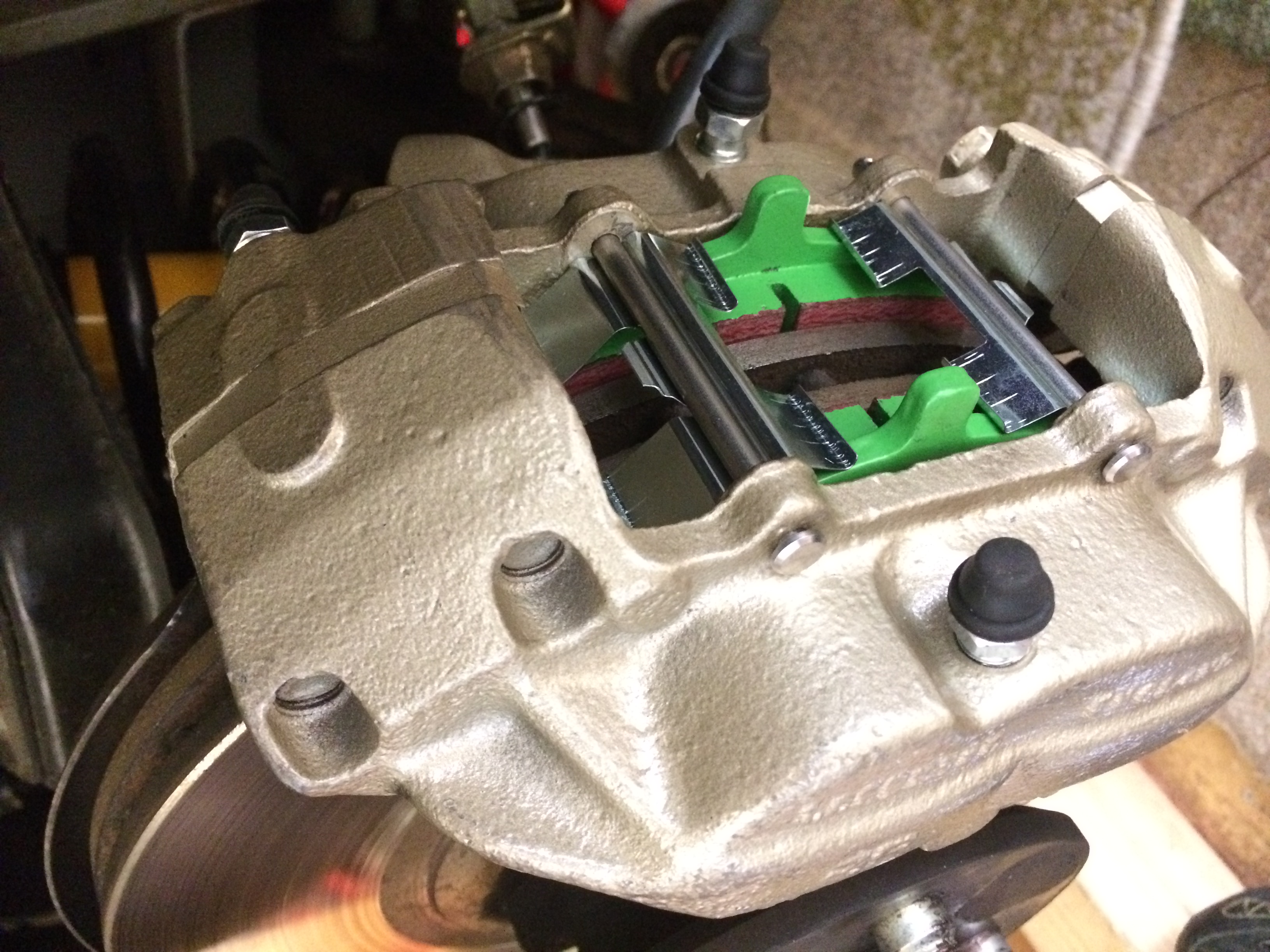

I did the same conversion last year and had the same 3mm pad overhang. l bought a spare pair of pads and removed loads of Pad plate from the sides being careful to keep the same shape, but to move the pads that far in I reckon you will have to remove loads of the back plate of the pads. l bottled it and put the standard pads back in as i didnt want the modified pads spinning out just when I needed them.
l left it with the overhang and have covered about 500 miles with no problems. just means I will have to remove the overhang every couple of years.
I have seen the same issue reported on capri and escort forums where the same mod is carried out.
Brakes are better with more feel, still not as good as modern brake systems. but that would need a new dual diaphram servo I think.
I posted about this on the other forum Undecided Undecided
Thats good news then...thanks for the info . Ive just noticed that the read brake pads are level with top...as stock.
looking at your photos you may have the anti rattle shim for the unvented disc calipers. There are wider shims made for the wider caliper I think. But I could be wrong.
