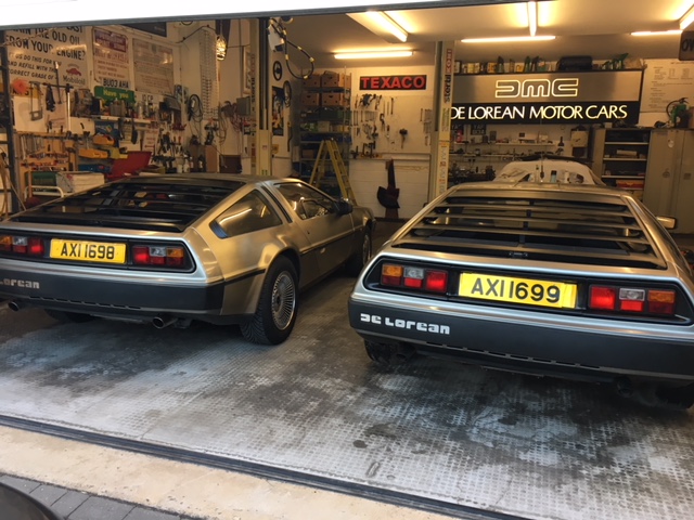

Yes, the first time in 35 years that they have been together again. Smile

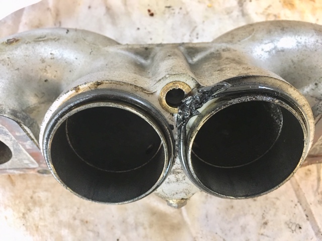

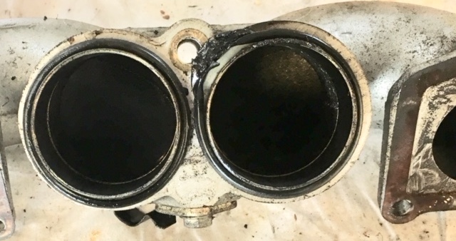

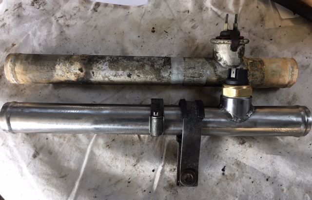

Looking at throttle butterflies ..very sticky...and black. My O rings were not much good either!   Now its all got to come apart anyway to refurbish the water pump, which is now leaking badly.
Replaced more of the water hoses and clips and while I was at it, ungraded the otterstat for the new design.
