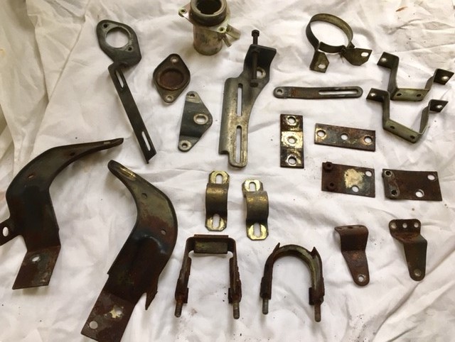

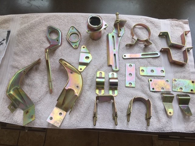

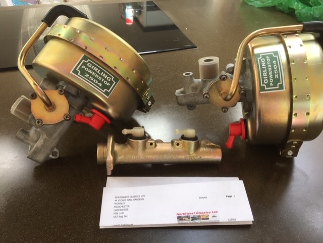

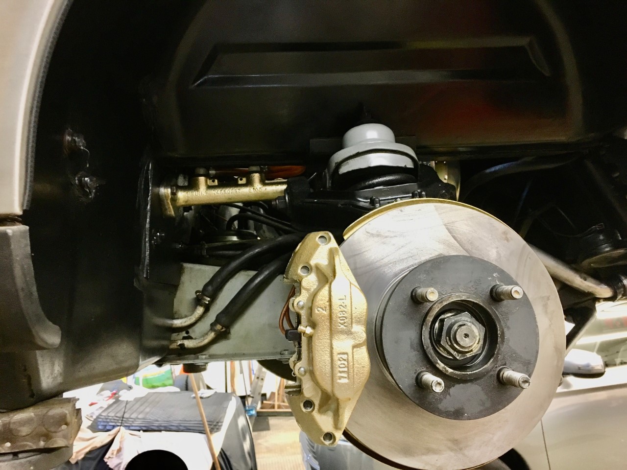

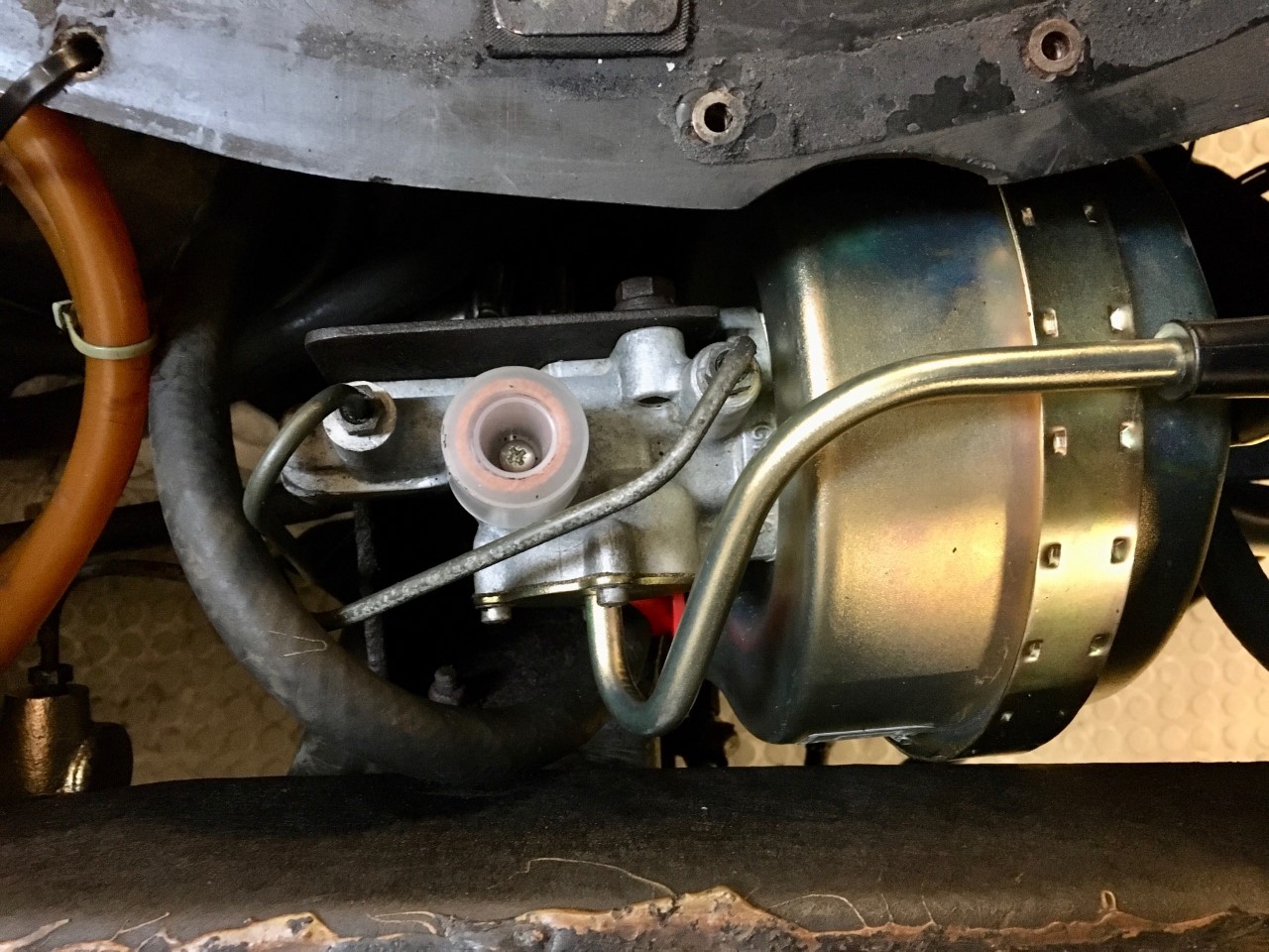

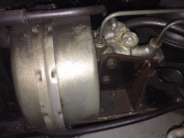

RE: RHD Project for auction, 1st Sept 2018 - Matt Clark - 26 Feb 2019 Happy bday Chrispy! RE: RHD Project for auction, 1st Sept 2018 - Matt Clark - 26 Feb 2019 Not sure - we're in NY next week for a week, and then I start a new job - maybe around April? RE: RHD Project for auction, 1st Sept 2018 - MrToast - 10 Mar 2019 (23 Jan 2019, 14:35)Chris P Wrote: I'm hoping so Stewart, but have not 'seriously' enquired until I have got an MOT in my hands. If it’s possible it has to be AXI..... If not you have your answer! RE: RHD Project for auction, 1st Sept 2018 - Chris P - 17 May 2019 A little update...still working on the brakes, my refurbished Brake servo's and master cylinder arrived yesterday , made a start fitting them, but packing for my holidays is more urgent! ![]() The brakes have probably been the biggest challenge. "living the outdoor life" as Matt puts it has taken its toll. I've had to replace or restore every single part of the braking system. Still not quite finished, due to holidays intervening, but nearly so. Getting stuff 'to bits' was the biggest challenge ...you don't just pop a spanner on it and off you go!! Oh no, every single nut bolt and washer was sized up solid. A lengthy and tedious series of.... WD40.... Heat gun....hammers and spanners, etc. has eventually won through. But I wouldn't have liked to tackle the job without a lift......and lots of spare time. One hasty action and you end up with something 'snapped off'. That hasn't happened, i've been careful, if long-winded. You have to be a bit like a Doctor..... "First do no harm".Everything that needed to come to bits, has been, and put back together with oil or copper grease etc. If only the Waxoyl that was used on the top of the engine (30 years ago) had been sprayed underneath the car....this job would have been done months ago. Still...on the final lap now. More later. ![]() More later...BTW we have a local club member and good chum who is looking for a standard silencer...Can anyone help? RE: RHD Project for auction, 1st Sept 2018 - Chris P - 14 Jun 2019 [attachment=573][attachment=574] Got a bit of re-plating done, Zinc and yellow.....rough cost at most platers would be about £40-50, but doesn't it make a difference!
RE: RHD Project for auction, 1st Sept 2018 - Rich Hanlon - 23 Jun 2019 Certainly surprisingly cheaper than the equivalent cost for powder-coating which is my recent experience. RE: RHD Project for auction, 1st Sept 2018 - Chris P - 23 Jun 2019 But more importantly Richard.....its as the factory did it! Not I slavishly want everything to look 'Factory'....but as you say, if it doesn't cost shedloads of money and it looks good why not? I regularly fit self-bleeders, better exhaust systems, better otterstat pipes, battery isolating switches, upgraded springs, better electrical relays and LED bulbs etc. These make the car more useable, but most of them 'Joe public' wouldn't spot. RE: RHD Project for auction, 1st Sept 2018 - Rich Hanlon - 24 Jun 2019 (23 Jun 2019, 07:55)Chris P Wrote: But more importantly Richard.....its as the factory did it! Indeed, if one is doing them anyway, then they might as well be 'right'. RE: RHD Project for auction, 1st Sept 2018 - Chris P - 11 Jul 2019 As Sir Henry Royce used to say... "what ever is rightly done, however humble, is noble". (He used to live about a mile away from my house). https://www.azquotes.com/author/48176-Henry_Royce
